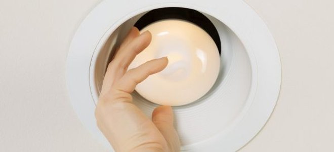

Recessed kitchen light fixtures are a sleek, modern way to bring light into the room and brighten up your space. But once the trim around those lights starts to get yellowed and old, those lights may not look so sleek and fresh anymore. But you don’t have to replace your entire light fixture to get an updated look. In just a few minutes of DIY, you can replace the trim around those lights and totally update recessed kitchen lighting fixtures with very little money and trouble.
Before you begin your project, check the numbers on your recessed lights to make sure you get trim in the right size. Pick out your trim and have the new stuff ready to go so you don’t have to stop your project in the middle. Once you have new trim for each fixture, you’re literally only a few minutes away from totally updated recessed kitchen lights.

Step 4 - Remove the Light Bulb
Remove the light bulb from the fixture and place it somewhere safe. Do not hold it in your hand or your mouth while you work; it’s worth it to take the extra time to climb down and place the bulb somewhere it won’t break, so you don’t have to juggle it while you’re working above your own head. (Always practice safety, even when your DIY project is relatively short and simple.)
Step 5 - Remove and Toss the Old Trim
Look for the pull tabs and/or springs around the lighting housing that holds the trim in place. If needed, use pliers to compress the springs to release the trim. Once you push the springs back, the trim should pop free so you can remove it easily. If it won’t come free, check for additional springs and pull-tabs that may need to be engaged. Throw the old trim away. Unless you plan to save it for a future DIY project, you won’t need the old stuff anymore.

Step 8 - Insert the Bulb
Screw your bulb back into the fixture.
