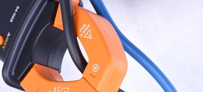

A clamp meter is a great tool to have when looking for a current value or amperage reading while working with electrical AC circuits. It's not magic, and learning to use it safely and effectively is relatively easy. Here's a brief explanation of what’s happening.
How a Clamp Meter Picks Up a Reading
These devices offer a quick way of reading the current going through an electrical conductor, from a few amps to thousands, without physically tapping into it. That is accomplished by the use of a ferrite core clamp at the top of the meter (Figure 1). The clamp is spring-loaded and opens by pressing a lever just below the tactile barrier while wrapping it around a current-carrying conductor (Figure 2).
clamp meter from two angles
The reading is picked up by induction, using the same basic principle applied in transformers, where an AC voltage is applied to a primary winding to create a magnetic force field around a ferrite core at the center of the transformer, which in turn is induced into the wrapped-around secondary winding.
The transformer built into the current meter is different from that of a voltage transformer in design with its primary winding consisting of only one or very few turns that can be of heavy gauge wire coil or just a simple flat turn looped around a ferrite core.
Current transformers can “step-down” the current level of the secondary from thousands of amperes down to standard output. The ratio of the loops between the primary and the secondary coils produces a secondary AC output inversely proportional to the current measured in the primary winding. The reduced resulting output makes it possible for the tester to monitor the current flow through the AC power line, by factoring the value for an accurate reading on the meter’s dial or digital readout.

1.6 - Open the jaws with the release lever and put it around one of the two conductors through which the current is to be measured.
1.7 - Release the lever to close up the jaws’ loop closing the two halves of the core together generating the magnetic field.
1.8 - The conductor must line up between the alignment marks on the jaws. If the clamp meter doesn’t have the alignment marks, The conductor should be centered inside the loop formed by the jaws.
