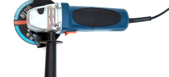

Anyone looking to update the appearance of their home or driveway can learn to use a concrete grinder with ease. Handheld models give you more control and cost significantly less than traditional models. With patience and practice, tackling countertops, floors, and patios will become second nature for anyone ambitious enough to pick up this powerful tool. A concrete grinder takes the guesswork out of finishing graffiti-covered surfaces and smoothing out rough edges. Versatile and durable, it can also be used to rough up floors before applying a finish. Regardless of what you intend to use it for, you'll need to become familiar with the characteristics and performance of your grinder.
Step 1 - Get to Know the Grinder
Each model has its own features. Before you set out to use your grinder, it is best to read the instructional manual for safety tips. Pay special attention to power switches. Note whether the brand you have is for use on wet or dry concrete. Some machines are equipped to deal with both types of applications. This type of information is often written on the grinder itself.
