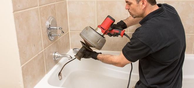

As a professional handyman, one of the most common calls I get is to unclog a drain. Unclogging most drains and piping systems in your own home can be done without spending extra dollars for a handyman like me to do the job for you. Sometimes a plunger will work for small clogs. But when a plunger isn't doing the trick, you're going to have to use a plumbing snake, also called an auger.
Plumbing snakes come in different sizes for different applications. Each plumbing system in your home is unique and you must make sure that you're using the right snake for the right plumbing system. Your local hardware store and large home improvement stores will have plumbing snakes for purchase, and places like Home Depot will have snakes or augers you can rent. Be sure to let them know what system you are unclogging and they will be able to rent or sell you the right snake for the job.
How to Use a Plumbing Snake
To use a snake on a tub drain, first remove the overflow plate located above the tub drain. Insert the cable into the overflow line. If you are unclogging a shower drain, you will have to remove the strainer on the shower floor and then run the cable into the drain. If it's a kitchen or bathroom sink drain, you may have to go underneath the sink and remove the trap. You can then run the plumbing snake through the drainage pipes.
Once the snake reaches the obstruction, you will have to turn the handle of the snake clockwise in order to get the tip of the snake into the clog. Then, twist, push, and pull the cable to break up the clog. With most drainage pipes, you will encounter bends and twists in pipes and will have to use moderate force to push past the turns.

Bathtubs and Showers
When snaking a bathtub or shower, a thin cable must be used in order to make the bends in the trap and also to prevent damage to the drain line under the tub. A snake with a cable thickness of 1/4" to 5/16" is ideal.
