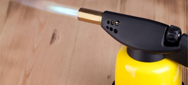

Soldering enables you to join two metal segments into one piece, using a torch and a softer metal as the adhesive. Before you start a soldering project, it’s important to set up a well-ventilated, clean work space. The following important tips will help to ensure that your soldering project is a success.
Step 1 - Organize a Safe Work Space
Place your tile on the surface of your work space. Put your fire brick on top of the tile. Place your torch and tools on the space around the tile. Take any items that might be flammable out of the area where you are working. If it’s not possible to remove a flammable item, be sure to use a heat shield to protect it from the heat of your soldering torch. Place your overhead light so that it shines over your work space. Put on your gloves, goggles, and apron.

Step 7 – Get Your Torch Ready
Attach the head to your soldering iron tank. Open the valve. When you hear the hissing sound of the gas, turn on your torch. Your flame should be around two inches. If necessary, make adjustments to the valve.
