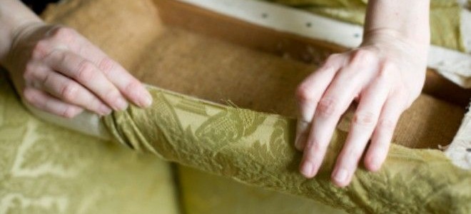

To ensure that the material you are using during upholstery or reupholstery is nice and taut, you will need to understand how to use an upholstery webbing stretcher correctly. Like anything, there are a few guidelines you should follow so you don't rip the fabric or make any other careless errors. Here's how to use both a slotted webbing stretcher and a gooseneck webbing stretcher.
When Using a Slotted Webbing Stretcher
This stretcher looks akin to a footprint, is comprised of wood in most cases, and includes a webbing loop and wooden dowel with a nice rounded handle for easy use.
Step 1 - Secure Webbing to the Furniture Frame
Place the end of the webbing across the furniture frame. The webbing roll should be facing you. Make sure that an inch of webbing overlaps the furniture across from you. Connect the frame to the webbing by using tacks or staples, your choice. Take the overlapping piece and fold toward you over the portion you have just tacked up or stapled. Use a few more tacks or staples to secure it, forming a W.
Step 2 - Get Ready to Use the Stretcher
Grab your stretcher, handle pointed up, with the dowel facing away from the frame of the furniture. Pull the webbing towards the near edge of the frame. Fold it into a shape that resembles a loop and insert the loop into the stretcher's slot. You will now use the dowel to secure it by positioning the dowel through the loop.
