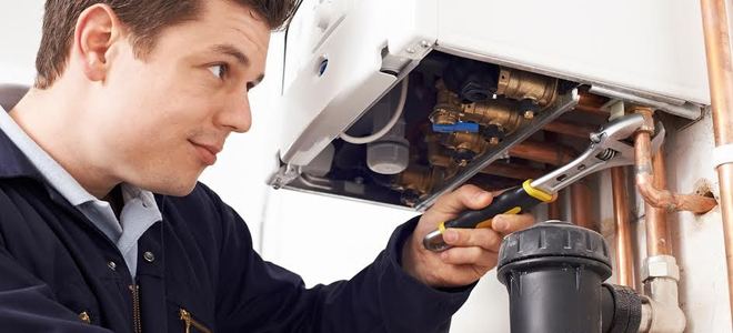

A handyman working on a boiler.

First of all, turn on the central heating system. Check the boiler to make sure there are no error codes and that it fires up correctly. The most common issue with the boiler, if it's a mains water fed type, is when the water pressure drops below 1 bar / 14.5 lb/in. The boiler requires the water pressure to be at that level in order to function. Boilers all have different methods of being recharged and you should consult your boiler instruction manual for information on how to do this. Generally it's a straightforward job, but it can depend on how the boiler was installed. If you're stuck, then consult a heating engineer who specializes in your make of boiler as they do vary quite considerably.

Now is also a good time to get the boiler serviced by a professional so that you can be sure it's in tip-top condition to get you through the winter months. Often you can save some money if you're not servicing your boiler in the middle of winter when the engineers are at their busiest, so do this as soon as you can. As part of the service, the engineer will check the boiler for any fuel or water leaks as well as check the heat generation parts to make sure it's running efficiently.
