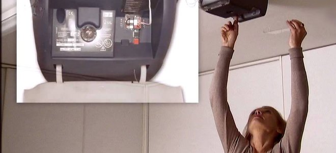

How to Wire an Electric Garage Door Opener
Lead Image for How to Wire an Electric Garage Door Opener
