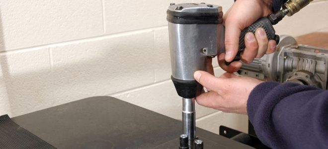

Step 1 - Inspection and Disassembly of the Motor
An impact wrench is a compact instrument, and there are chances that the motor may not be assembled correctly, and for this reason, it may be giving you trouble. To check the assembly of the motor, you'll have to disassemble it.
From the front of the motor, lift the rear hammer washer and remove the two motor washers. The motor is assembled in a small area, also known as the motor housing. Once the washers have been removed, you can remove the motor by simply grasping the splined end of the rotor and removing it.
Step 2 - Cleaning and Lubrication of Motor
The impact mechanism inside the hammer case may need to be cleaned and lubricated. Use a clean cloth to remove the dirt and grime caught on the grease. Using a machine lubricant, soak a small piece of cloth and apply it to the smaller parts of the impact mechanism.
Step 3 - Assembly of Motor
Place the reverse valve bushing seals properly into the undercuts on the valve bushing. The reverse valve should be dampened with light lubricating oil to make sure that it continues to move. Install the detent spring of the reverse valve in its proper hole.
Move the wrench so that you are facing the handle and the wrench is in an upright position. To make sure that the reverse valve is moving, rotate it in the left to right motion in the reverse wall bushing of the splined end.
The reverse valve knob can now be attached to the knob screw. Use a screwdriver to tighten the screw to a torque of 60 to 70 inch-pounds. If the throttle valve seat has been misplaced, install a new one by pushing it into place using a dowel measuring ½” diameter. Insert the trigger assembly back into the trigger bushing.
