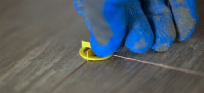

For the grout illusion to look professional, you need to leave some space between each of the tiles. Use spacers that you would use for a regular ceramic or other type of tile. As you install each adhesive tile to the floor, place a spacer between the new tile and the next tile. This way you will ensure that the spaces are even and consistent.
