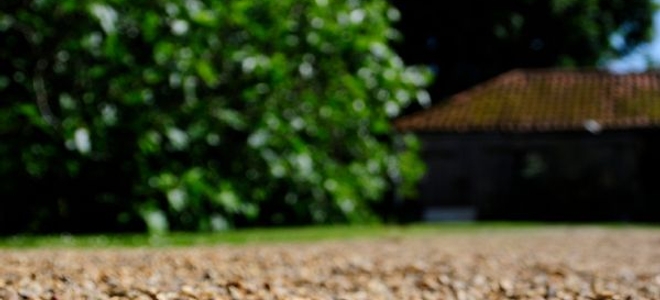

Install a Long Lasting and Durable Driveway With Gravel
A close-up image of a gravel driveway with a house and a tree in the background.
