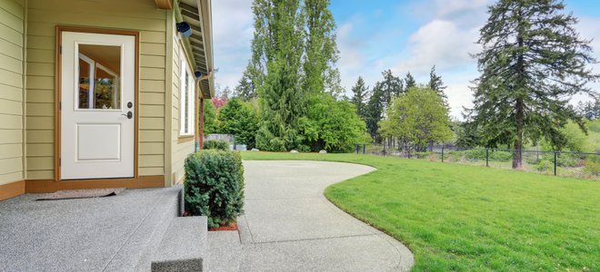

When it's time to update your yard or landscape, consider laying a stamped concrete patio over your existing patio if its surface is in good condition. Diligent cleaning and preparation will produce a beautiful, durable new patio surface. Use the guidelines below to install a stamped concrete patio.

Starting at the edge nearest the house, lay and press down the stamping mats with a tamping mallet. Leave the stamp mats in the concrete for about 10 minutes to imprint a clear pattern. Lift and move them carefully across the patio until the entire area is stamped.
