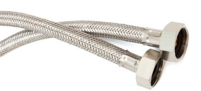

Installing Flexible Lines
Older homes have copper line running from the shutoff valve to the kitchen faucet. These lines will eventually corrode, generally at the fittings, which can cause damage to the cabinet and produce mold. A quick fix is to install the newer style of flexible lines, available at almost any hardware store. These lines can be moved up and out of the way, allowing more storage space under the sink.
Step 1 – Turn off the Water
Shut off the water valves to the faucets. You might see some leakage here because the valves are usually not turned off and on unless repairing or replacing the faucet. Be sure to put a drip pan under the valves.
Step 2 – Remove the Old Lines
Using the proper size open-end wrench, remove the supply line from the valve. There is a very handy tool available on the market that allows you to remove the lines from the faucet. Called a basin wrench, it has spring-loaded jaws that swivel 90 degrees, allowing the user to either loosen or tighten the faucet nuts. Newer faucets have plastic wing nuts that can usually be turned by hand.
Step 3 – Attach the New Lines
Attach the new flexible lines in the same way you removed the old ones. First to the faucet, and then to the water supply valve. Turn on the water, and check for leaks.
Installing a New Supply Line to a Toilet
The old supply line, generally chrome tubing, can corrode with age and begin to leak. A good replacement for this line is a stainless steel line. Coming in a variety of sizes and lengths, this offers the most flexibility and makes installation a snap.
Step 1 – Turn off the Water and Drain the Tank
Shut off the water supply at the valve. Then flush and drain the tank.
Step 2 – Remove the old Line
Put a drip pan in place to catch any water that leaks. Using an adjustable wrench, remove the old line from valve. Remove the line from tank. The basin wrench will be a big help here.
Step 3 – Install the New Line
Attach the new stainless steel line to the shutoff valve. Do the same on the tank end of line as well. Finally, turn on the water supply and check for leaks.
