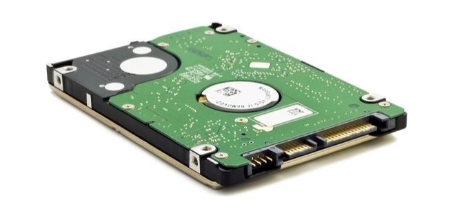

If you want to enjoy all of your favorite MP3s in your older vehicle, you can install an external USB hard drive that can hold literally thousands of your favorite tunes. Installing a USB computer hard drive in your car is not difficult and can be done in less than an hour. This simple guide will show you how.

Choose an installation location for the external USB hard drive you will be using with your stereo head unit. When considering the location, you should realize that the USB protocol does have limits on the length of the cable. The length of USB cable you'll be able to use will depend upon the USB protocol used with your car stereo head unit. If you are unsure of the protocol used with your unit, try to keep the cable length between the hard drive and the stereo less than three meters. Therefore, consider installing the hard drive on the dash of the vehicle or on the console. Secure the hard drive in place with double-sided tape.
