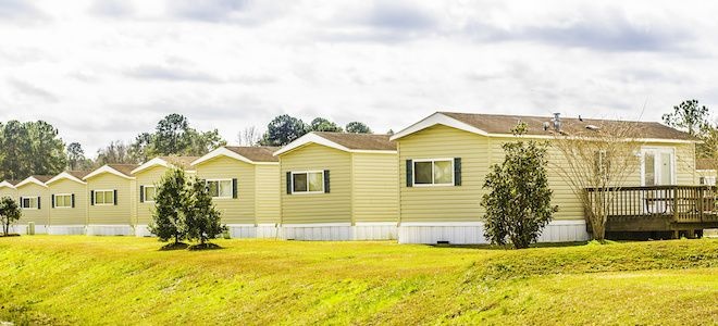

While a mobile home can easily feel like a small place to live, including a porch addition can greatly enhance the feel of the space and provide additional room in which to spend time. Porch additions are a great project for anyone who has a mobile home and a decent amount of space in front of the home. They are best for situations in which you'll not leave the mobile home for extended periods of time so that you can monitor the porch, and for people who will not move the home, either. Read on for a brief guide on how to make a porch addition to your mobile home.
