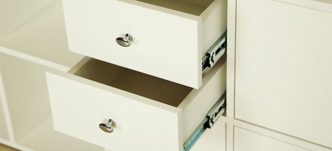

Installing the Drawer Runner
After you have decided on the type of drawer runner you want to install, the actual installation of the drawer runner is not complicated.
Step 1 - Start by screwing the runners to the sides of the drawer. The runner on one side of the drawer should be parallel with the one on the other and at the same distance from the top and bottom. If it is not parallel, the drawer will sit crooked and not function properly.
Step 2 - Next, hold your drawer in the cavity where it has to finally fit and make sure that the sliders are fully closed. Use you pencil to mark tiny circles where the holes for the screws will need to go on the inside.
Step 3 - You should be able to use a drill or screwdriver to install the screw, but this will depend on what the type of material you are using and if you are using self-drilling screws. If you have to work with wood, using a bradawl on the marks you made will be helpful.
Step 4 - Finally, remove the drawer and use a screwdriver to slightly loosen each runner. Now check the alignment with a spirit adjuster and when you are satisfied, tighten the screws. You can now glide the drawer into place and enjoy how smoothly it works.
