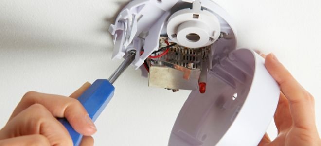

Smoke alarms are a critical part of home safety, especially when most house fires occur at night or early morning when everyone is asleep. The way a house is set up and protected should be a major concern for everyone since it concerns the well-being and safety of the whole family and considering a system upgrade might not be such a bad idea, especially since detectors only have a 10 years lifespan.
Hard Wired or Battery Operated
Battery-powered detectors are easy to install and use since they don’t require terminal boxes or wiring, and they keep working during a power outage. They are a cheaper option for an older home where hard-wiring inside finished walls and ceiling can quickly become a costly project. They do have the set-back, however, to need immediate attendance when battery replacement is required, which should be once or twice a year unless it has a10-years lithium-powered battery (Figure 1a & 1b).
Some battery-powered detectors are equipped with the wireless capability to communicate with other units through radio frequency transmission, making it a much more effective alternative than its solitary counterpart, by activating an alarm throughout every unit installed in the house, alerting everyone at the premises during a fire. Since they also rely solely on batteries, however, they should be purchased with the lithium batteries.
Shop Hard-Wired Smoke Detectors on Amazon
The Hard-wired alarms are probably the best option while a new building is under construction. They are approved by construction code and are much easier to install in a new construction project while the wood framing is still exposed, but the terminal boxes and wiring required throughout the house make it more costly for the installation, but much less so than after the walls and ceilings are finished (Figures 2-4). Hard-wired alarms inter-connected together throughout the house will all sound at once when one unit is triggered by fire or smoke, but is much more reliable than the wireless system, since electrical interferences around the house or battery failure is never an issue, especially when equipped with the backup 10 years lithium batteries.
