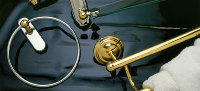

How to Install Towel Holders on Tile Walls
A close look at several pieces of hardware for your bathroom.

A towel holder is a necessary feature in a bathroom. The most convenient towel holders hang on the wall, but installing these on tile walls presents some unique challenges.
Before you proceed with the install, carefully chose a convenient location for the towels to hang. Locate them in a place that is easy to reach from the sink, the tub, and the shower.
There are two different types of towel racks that can be installed on a tile wall. These include racks that are glued to the tile and racks that are installed by drilling into the tile.
