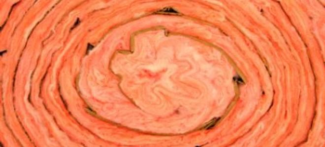

When upgrading insulation, it's often easier to add more insulation to an attic using fiberglass bats or blankets. Start at one side of the attic and simply lay the insulation in between the existing joists until the cavity is full. When the cavity is full, you can lay more insulation at right angles across the insulation already there.
Insulation works best when it isn't compressed, so just lay it down; don't squeeze the fibers together. If you are adding more insulation to what was originally installed, you don't want to add another vapor barrier on top of the existing one. This means if you're using fiberglass batts or blankets, you want to use unfaced products (facing on insulation is designed to act as a vapor barrier).
