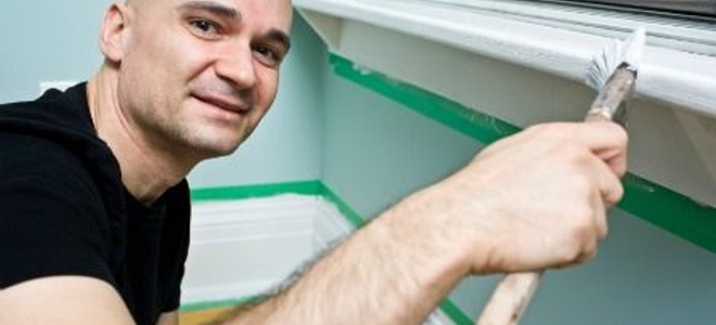

Painting the Trim
After you have finished all the large surfaces, you’re ready to paint the trim and woodwork. Up until now most of your work has been on large surfaces, and detailing was not important. To do the trim, you need to change your mental set about painting. You are changing from rough work to finish work. Attention to detail and care at this stage means the difference between a professional looking job and a sloppy one.
Your tools will also be different. During this stage you will use the smaller angled brushes and metal paint guide. A 1 ½-inch angled sash brush is often used for narrow molding, and a 2-inch trim brush on wider trim. As you apply the paint to the trim and woodwork, keep a supply of clean rags near you to immediately wipe off any excess paint that gets on the previously painted surfaces. With oil-based paints, use a little mineral spirits or paint thinner. With water-based paints, use water. For a more durable finish, oil-based paints are most often used on trim. With these enamel paints, fingerprints are more easily removed. On trim that has been previously stained, bleeding may occur. In this case, two coats of shellac are needed first.
Start with the horizontal surfaces and then paint the vertical surfaces. Begin with the trim closest to the ceiling and work down. Do baseboards last. When doing baseboards, paint the top edge first, then the floor edge, and finally the large center area with a larger brush. Be sure to cover the edge of the floor with a paint guide or masking tape.
