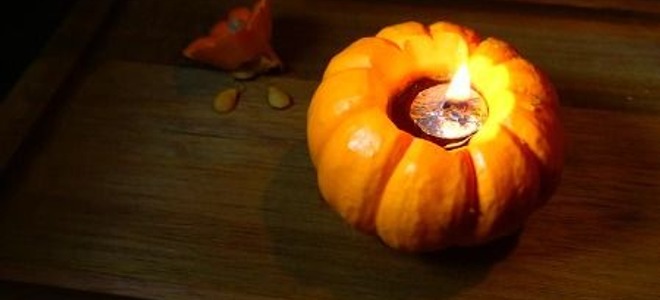

The Wick's the Trick
I started by making the floating wicks for the lamps. Using a utility knife, I cut ¼-inch discs from the cork of a wine bottle. Each disc got a small hole bored through the center, then one side was covered in aluminum foil. I cut 1 ½-inch lengths from a spool of cotton wick and threaded them through the cork, starting on the aluminum foil side to keep that material from tearing out too much. These wicks will float on top of the olive oil. The foil on the top protects the cork from the burning wick.
mini pumpkin olive oil lamp
Miniature-Pumpkin Carving
After I completed the floating wicks, I turned to the pumpkins. These were the very small variety, usually sold for decoration only. Using a paring knife, I cut the stems out the same way you would with a large pumpkin for a jack-o-lantern. The pumpkins were too small to use a regular spoon to collect the seeds and guts, but a ½-teaspoon measuring spoon worked perfectly. The hollowed out pumpkins were ready for oil. I carefully poured it into the void, bringing the level just to the bottom of the thick skin around the opening.
Lamp Assembly
I adjusted the wicks in the corks so there was about ½-inch on the top side. When the wick floated on the oil, the bottom portion helped anchor it and kept it centered. I waited a few minutes to let the oil permeate the wick. After that, it lit quickly.
mini pumpkin olive oil lamp, indian corn menorah, Thanksgiving desert dreidel
Standing back, I took in the glow. The flame took the place of the stem, completing the shape of the pumpkin. And the fire radiated through the orange skin, creating a festive, warm light, perfect for gatherings of friends and family, and traditions old or new.
