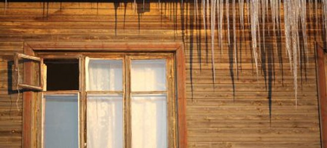

Keeping the Drafts Out
An old house with icicles and an open window.
