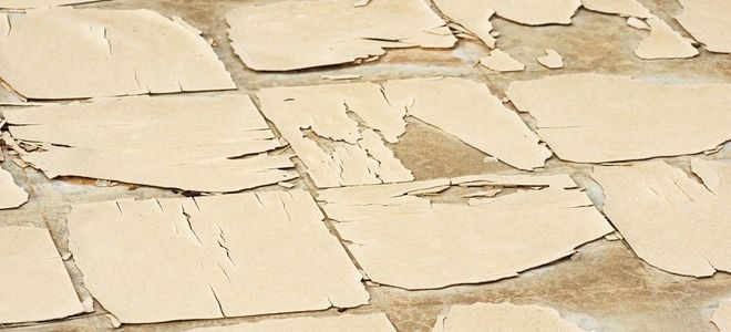

Steps For Giving New Life To Old, Yellowed Linoleum
