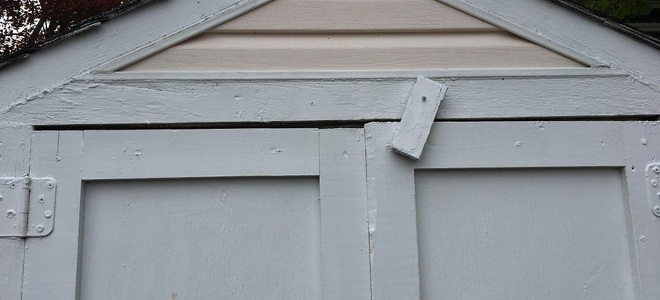

Step 2 - Protect the Windows and Doors
Cute outdoor shed
This is very important because normally water tends to drip from windows or door cracks. First check if the window putty is still intact. If not, you will need to add some more. Before adding the new putty, you have to clean the old one properly. Use a cutter/knife to get rid of the old putty. Alternatively you can use silicone instead of window putty.
If you don’t have any rain protector over your door, it is advisable to fix one. All you need is a piece of inclined wood nailed on the top part of the door. The latter will help prevent rain from seeping in.
