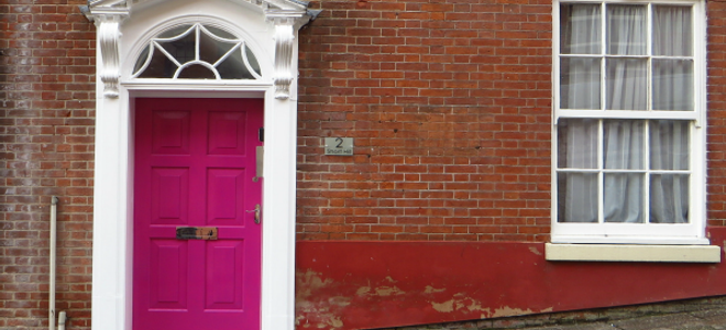

Ever walk by the paint chips in the home store and marvel at all the different shades of your favorite color? You may not want to douse your whole house in a cornflower blue or a cherry red...but why not put a shade to use on your front door? That small pop of color may be just what you need to brighten your day, and you don't have to give up your home's design aesthetic (or leave the neighbors scratching their heads) to achieve a unique look. We share how to get there in the following steps.
