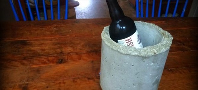

This year, I’ve been experimenting with concrete, so I knew I wanted to use that material to come up with a good sized project to make a statement. They don’t know it yet, but for the holidays, the in-laws are getting a concrete wine bucket.

Using a shovel to move the bulk of the concrete, I filled the large vessel about 2/3 full. Then I set the smaller bucket in to it, pressing down so as to raise the level of concrete up the sides. The form still wasn’t completely full, so I used a trowel to fill in any gaps.

Because concrete tends to have a constant dusty texture, I hit the bucket with a spray sealant. Then it was ready for a bottle of wine and gifting. There’s plenty of room in the bucket for wine and ice. Or, if your freezer has enough space, you could put the whole thing in there, then bring it to the table, where it should keep the wine cold for quite some time.
