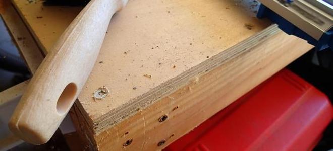

I like decking screws for a nice, secure feeling, but if you prefer heavy metal head banging, nails would also work for joining the 2x4s. Create the top and shelf rectangles first, then fix the legs to the insides of the frames.
You have your basic structure now and can use the wood screws to affix the top and shelf to the frames. I didn’t use glue on my tops with the idea that if the wood eventually wore out, I could easily unscrew and replace it. Having an informal surface like that in the shop is great for everything from painting to jotting down notes on the fly.
Notes on the work surface.
