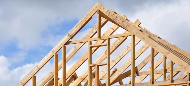

Installing a roof truss is a serious project that must be performed with great care according to exact specifications. The trusses are important structural units which bear the load of the roof. The size, spacing, and span of the roof trusses must be carefully calculated to hold the weight of roofing materials and accumulated snow. Prefabricated trusses are available from hardware stores and these are appropriate for a wide range of common projects. Specialized applications will require the builder to frame their own trusses using 2x4s or 2x6s.

Roof trusses are usually installed 24 inches on center, but check the manufacturer’s codes and local specifications. It’s possible that these may require 16 or 12-inch spacing. Starting at one end of the roof, mark the first truss flush with the outside edge of a cap plate. Use a level, square, and measuring tape. Hammer a nail in place to hook your measuring tape and space out the subsequent trusses every 2 feet or other designated spacing. Measure out 5 to 6 trusses at a time. Mark the landing point of the truss heels on one side and then the other. To make sure that the first pieces of 4 foot by 8-foot plywood roof sheathing sit flush with the first truss but land in the middle of other trusses, you may have to reduce the spacing between the first two or three trusses by ¾-inch.
