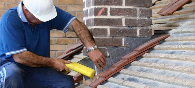

Installing vents with roofs covered in metal roof flashing is actually much easier than you might imagine. All plumbing systems need to be vented to work properly, venting opens the system up to air and also helps to get rid of noxious gasses. When installing these systems it's essential that you replace the flashing properly so that your roof is fully watertight.

Step 5 - Flashing
Pull out any nails which are still in the roof, but take care not to dislodge the vent pipe. Now the piece of new flashing can be placed over the pipe and put into place. The flashing needs to be flat when installed and should be held in place using roofing nails.
