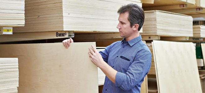

All About Plywood
A stack of plywood in a home improvement store.
Historically, plywood has been the most popular material for building inside of a home even though OSB has become more prevalent, especially in recent years. Plywood is versatile, highly durable, and stable. It has high impact and high chemical resistance.
The Advantages of Plywood
Plywood has a great reputation and is well-trusted with a solid performance track record. This wood is also available in a range of appearances, allowing the material to fit the wants and needs of any project demands.
Plywood is also very strong and stiff, meaning that it’s extremely durable. This sets the material apart from OSB, as the bending stiffness of plywood is 10 percent greater than OSB at equal joist spacing.
Perhaps one of the most notable advantages is that plywood has great moisture resistance. It also boasts quick drying times, surpassing those of OSB. Finally, plywood makes the perfect underlayment, acting as a great subfloor because you don’t need to worry about swollen edges that will loosen or weaken the tiles atop the wood.
The Disadvantages of Plywood
We’ve briefly touched on these cons, but the first one is that plywood is a bit more expensive than OSB. Additionally, this material does not come in sizes as large as those that OSB is available in, making it a little more difficult to use when boards of larger magnitude would simplify the project.
