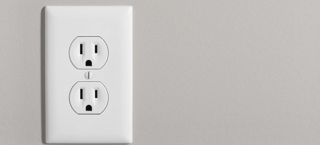

People often get nervous when it comes to electrical work, but you'd be surprised at just how easy wiring an outlet can be. While basic home wiring is a safe do-it-yourself project if done properly, if you don't know what you're doing, you could get injured. As with any job you undertake, safety is the number one priority. The mantra to a successful electrical repair or installation is Respect the Electricity!
There are many reasons why you may want to install a new outlet, but more often than not it's because the room does not have enough or there isn't one near enough. The level of difficulty for this project depends on where the outlet is going in relation to the existing ones. If you want to install an electrical outlet on a different wall from the existing ones, it can prove to be a little more difficult.
