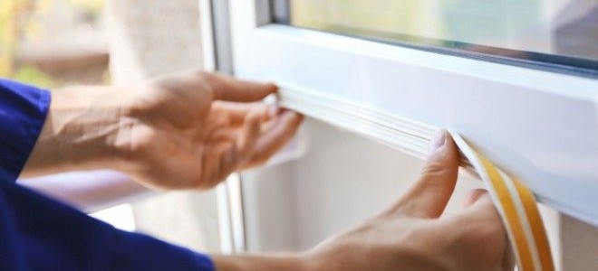

The piece itself could be replaced if you are an accomplished carpenter or do-it-yourselfer, but most folks find a more successful way of keeping their windows weather tight is by the use of weather strip.
You may place adhesive weather strip on the side of the parting stop or strip when the window is open. Then when the window is closed it will form a tight seal between the sashes that air will not penetrate.
