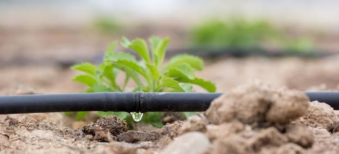

Black irrigation pipe laying in the middle of a garden on soil.
It's easy to set up a water irrigation system to recycle greywater. Once you have the layout of the piping installed in the yard, you can then choose which source or sources will supply the water. For example, if you plan to recycle water from the washing machine, all it takes is the installation of a few PVC pipes, a hose, and a three-way diverting system. The diverter is installed as an attachment to the washing machine and gives you the option of allowing the water to drain from the washer in the normal way to the sewer, or flipping a lever and having it go to select irrigation areas.
When using the washing machine as a source of recycled water, two things are important to remember: 1. If you use bleach in your laundry, do not allow the water to drain to the areas to be irrigated. Bleach is not plant-friendly. 2. Use eco-friendly detergent.
The piping runs from the water source (washing machine, sink, shower) in the house and to the pipes laid throughout the yard to address areas where plants are to be watered. Along the piping outside, individual "T" systems are installed to disperse water at these locations as it runs along the pipes.
The "Ts" are placed strategically along the entire irrigation route and placed inside a box that keeps it raised off the ground and allows the system to operate freely while remaining safe and secure. Mulch is then placed evenly around each of the valve boxes to act as a filter. The mulch captures lint, for example, which helps prevent clogs in the hose.
You can place as many "T" systems as you like along the hose to make sure the plants that need water will get it every time recycled water is diverted to the irrigation system.
