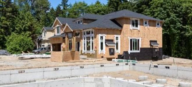

Neighborhood construction with house foundation in the foreground and partially finished house in the background.
If you're constructing a house or adding on a room, you will encounter the question of what foundation to build. Depending on where you live in the country, your home will likely be built on one of three types of foundations: slab, crawl space or full basement. Each has advantages and disadvantages and, generally related to climate, are common in different areas of the country. Here's a quick overview of each type of home foundation and some of their pros and cons.
