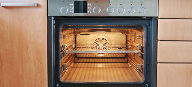

Power Feed to Control Board
Figure 2 shows that all the wiring to the board are plug-ins. There is one lone black wire plugged into P5 that runs all the way to the back and is connected to a large terminal block with three posts (Fig. 3). A black, red, and white wire are connected to it coming from the junction box on the wall.
After disconnecting the black wire leading to the control board from the terminal block (thus isolating the wire), connect one lead of a multimeter to it while connecting the second lead to the other end of the same wire which plugs into P5 of the control board. With the multimeter set on continuity, identify that this is the correct wire by looking for a no resistance (zero Ohm) reading.
Terminal Block
Device Operation
From the terminal post where the black wire was just removed, a heat resistant wire will be added and fed to the 120 VAC coil of a delayed relay, and to a NO (normally opened) contactor of that relay through a wire jumper. The other side of the coil will have to be wired up to the neutral (white) terminal post of the terminal block.
The black wire initially disconnected from the terminal post can then be spliced and connected to the other side of the contactor on the relay and complete the circuit. If the delayed relay is set for five minutes when the power feeds the coil, there will be a five minutes delay before the contactor closes the circuit activating the control board, well after the voltage was restored and stabilized.
