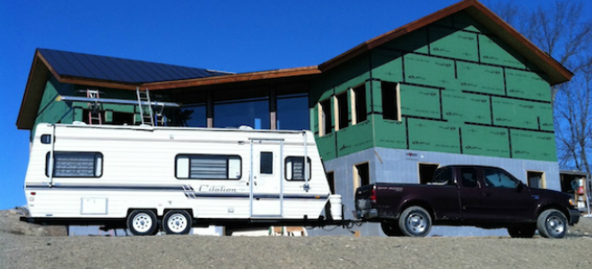

Occasionally life affords us exciting opportunities that sound great but for a few minor details. For me, one such opportunity was to help build a custom timber frame home for a couple of friends. The catch was that I’d be living on their 18 acres of Hudson Valley property in my 26-foot travel camper for as long as I was working on the project. The other catch was that, until they drilled the well 19 months later, there would be no running water on the property. So for the first couple of weeks I bought my water from the grocery store in 5-gallon increments. But it wasn’t long before I realized that wasn’t going to be a sustainable system if I was going to be sticking around this job for the long haul.
