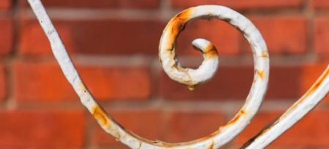

Metal is a wonderful, versatile, eco-friendly, and easily maintained material. One issue with it, though, is that most metal rusts at some point. If it contains even a small amount of iron, the metal will oxidize when exposed to air and moisture. Oxidation on iron and steel is easy to spot by its reddish brown color and its tendency to powder or flake off. Rust creates hard bubbles under paint, eventually erupting into lesions that erode the metal until it crumbles. If there is rust in your life, whether on tools, metal furniture, fittings, posts, or fencing, it is best to deal with it as soon as you can. Before you begin, here are a few steps to take when painting rusted surfaces.

Step 3 - Remove Surface Rust and Flaking Paint
Rusty door hinge
Begin by scraping off all flaking rust. If space allows, a Dremel with a wire brush can reduce the time required for this step. Buzz the rust and old paint away. With this tool, you should be able to get down to bare metal without too much effort.
