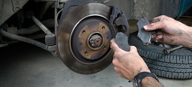

When it comes time to repair brake rotors, there are a few things you should know. A brake rotor is something that can be resurfaced and repaired several times before it must be replaced, making it an auto repair you should take the time to do. It is important that you know when it's the right time to resurface a brake rotor. If brake rotors are resurfaced too much, it can result in shortening the life of the rotor as each time it's resurfaced, the rotor becomes thinner.
Step 1 - Know When Resurface Is Necessary
One of the main reasons for resurfacing brake rotors is due to parallelism. If you notice that your brake pedal is pulsating, this is one of the first indicators brake rotors need to be resurfaced to restore parallelism. Also, look for rotor scoring. Rotor scoring could be a cause of a bad pad formulation.
