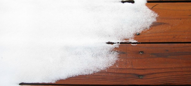

Most wooden decks are constructed with treated lumber that is able to withstand the harsh effects of weather. While this type of lumber is very durable, it can become damaged if it is not properly maintained. Because moisture and mildew growth can quickly cause your deck boards to split and warp, it is important to repair any damage caused by winter weather as soon as possible. You can avoid these problems by properly cleaning and protecting your deck after the winter months. If you take good care of your deck, you will be able to enjoy it for many years to come.
Remove Snow and Ice
As the winter weather comes to a close, temperatures grow warmer but there may be some residual snow and ice lingering on your deck. It’s important to clear your deck as soon as possible to prevent your boards from becoming warped or split. A plastic shovel is the best tool for this type of job as it will not cause damage in your attempt to force the remaining ice and snow off the deck. Be sure to push your shovel along the length of the boards. Pick up the snow and pile it in a spot away from your deck. Stay away from applying a salt or chemical product onto your deck because these materials can cause your wood to discolor and weaken the protective coating on your lumber.
