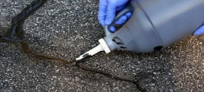

Step 4 - Fill the Cracks
Use your rubberized asphalt filler to mend any cracks and holes that are less and a half inch in size. Keep the filler off of any undamaged areas as it will cause staining on the asphalt. Attach the filler to your caulking gun. Squeeze the caulking gun to apply the filler to the cracks and holes. Use your putty knife to smooth out the filler. Allow the filler enough time to dry fully before you use your driveway.
