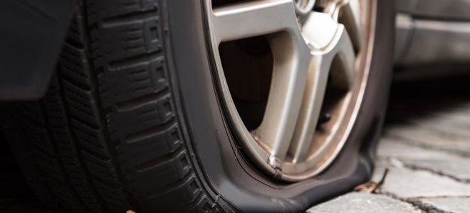

If you are having problems with air pressure leaking from your tire, then you may have a problem with your tire valve. These are designed to control the amount of air pressure inside the tire, and if this is leaking, then you will find you regularly have a flat tire. With a faulty valve, you will lose balance on that side of the car, which can make the vehicle difficult to handle, and even dangerous. In order to protect yourself, you need to ensure you repair the leaking tire valve quickly. Repairing this valve is not too difficult.

Examine the edge of the wheel rim, and check that it is not damaged or rusty. This could be the cause of your tire problems, and repairing or replacing the valve would not work, as the rim will simply continue to do damage. If you find a problem, then you need to replace the entire rim. Once the rim has been checked, take the cap off the valve and run a little soap and water over the ends of your tire valve. Bubbles will show that the valve is leaking.
Step 3 - Replace the Core
Using a valve core device, extract the inside of the valve. You can then replace the core by inserting a new valve core into the center. Screw this in tightly, making sure you don't strip off any of the threads, as this will prevent the core from working properly. Add some rust cleaner around the edges of the valve, as this will stop it from developing rust in the future.
