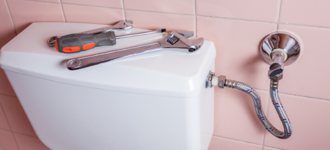

While many problems arise in the bathroom, one of the most common is a leaking toilet tank. The good news is that the one easy approach is simply to adjust the toilet tank plumbing to repair leaks from the tank. If you become aware of water leaking on the floor or between the toilet tank and bowl, then you should try and fix the leaks quickly. If you ignore the leaks, your water bills will be more expensive because of undue water wastage plus the water could cause damage to your floor. You do not have to call a professional plumber but you can try to do the plumbing job yourself without a huge time commitment.

Turn off the water valve near your toilet tank and put a large towel on the floor to dry the water that leaked. If you are not able to locate the valve, then you have to turn off the main water supply.
Step 2 - Empty the Tank and Remove the Water Tube
Remove as much water as you can from the tank by flushing it down the toilet. It will not refill with the water supply turned off. Dry the rest of the water left in the tank with a sponge or rag. Use a pair of pliers to remove the water tube from the side of the tank.
