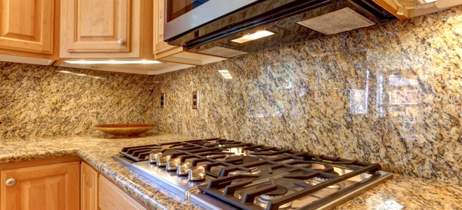

An over-the-range microwave in a granite kitchen.

Next, unplug your microwave and evaluate how it is mounted. Most commonly, you will find screws inside the cupboard above the microwave. Unscrew the mounting screws while supporting the microwave. Often, the microwave has secondary support via a wall-mount to hold it in place without the screws. Ask for assistance while unscrewing and lifting the microwave out of place. If it does not slide directly out, try rotating it forward or lowering the front slightly. Once the microwave it out, remove any additional hardware. Your new microwave should come with its own mounting plate so you can remove and discard your old one.
