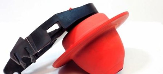

Flapper Valve
A toilet surrounded by plumbing tools.
The flapper valve is the mechanism inside your toilet tank that controls the flush. When you push on the handle, the lever lifts a chain that in turn, lifts the flapper valve. The valve covers an opening in the bottom of the tank that allows the water to flow down into the bowl and creates the flushing action.
This valve is usually made of rubber, which can become hard and brittle over time. Issues arise if it doesn't seal correctly over the opening at the bottom of the tank and water seeps down into the bowl. The problem is usually identified by your toilet running non-stop. The tank keeps trying to fill itself unsuccessfully because all of the water is leaking around the edge of the valve.
In order to change the valve, you first need to empty the tank of water so that you can work. Find the shut-off valve located on the water line that supplies your toilet. Turn it off, and then flush the toilet one time. The tank should empty as normal with the flush, but will not refill.
There are several different styles of flapper valves, and the best way to ensure that you get the right one is to remove it and take it with you to the store. Install the new one into the clips that held the old valve in place, and then turn the water supply back on. It should be as good as new.
TIP: Mark says, “Check the flush valve, the part where the flapper rests to seal. Remove any debris that may be stuck there.”
