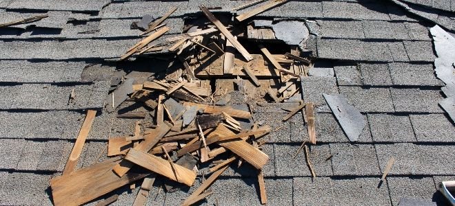

If your roofing gets damaged, moisture will find a way inside your home sooner or later, potentially causing more problems inside. Here's how to reroof safely and effectively.

Inspect the Decking for Cracks, Gaps, and Nails
Step 3—Once the roof deck is cleaned down to the boards, inspect the decking for cracks or other defects that may even require adding sheeting to the deck. Inspect for protruding nails or other objects to get a smooth and even surface. Use a push-broom to sweep the overall surface of your deck.
