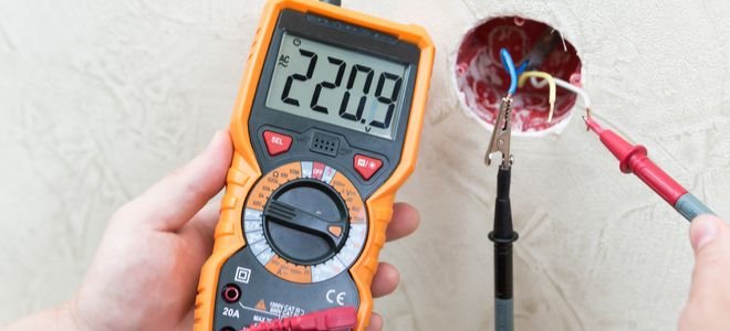

All the circuit breakers feeding the vicinity should be turned off to prevent the risks of electrocution or fire from a short circuit. If there's any chance of damaging plumbing, the water supply should be turned off as well.
The immediate area of the wall should be scanned with a digital multi-scanner as a secondary precaution to detect metal plumbing and electric wires and help prevent accidental damage.
Always proceed with caution while working inside walls, probing and feeling for any resistance or obstructions from undiscovered items.

The cable can then be attached at intervals to the basement’s ceiling joists right up to the electric panel. Before removing the front of the electric panel, a battery-operated trouble light should be put in place to illuminate the work area. The main circuit breaker feeding the panel (Figure 5) must be turned off so the power is cut off to the whole house.

To prevent a surge of power through the house, it's a good idea, before switching on the main power breaker, to switch all the breakers off inside the electric panel. Starting with the main breaker, turn every breaker back on one at a time, leaving the newly added breaker for last. The 220 volt appliance can now be plugged in and tried out!
