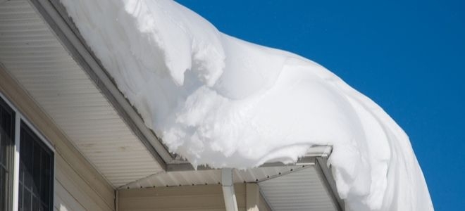

Roof snow removal can be necessary when you experience a heavy snowstorm, or have several smaller snowstorms in a row. Too much snow piled up on a roof can cause it to bow or cave in, resulting in serious home damage. Cleaning the roof snow can be quite dangerous, though. Safety should always come first, and when possible, tag-teaming a roof snow removal DIY is always a good idea.
A heavy, saturated snow is especially tough on a roof, and in a worst case scenario can cause thousands of dollars in damage, as well as wrecking irreplaceable items like antiques or family photos. You don't just have to worry about a cave-in and flooding your home, though. If the snow on your roof doesn't cave in, it can still damage the roof while melting. The resulting water can cause severe warping or rotting of roofs, ceilings, and other building elements.
To avoid a collapsed roof or water damage in your home, here are some guidelines for effectively removing snow from your rooftop.
