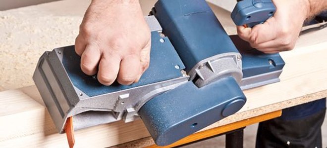

Belt sanders - A belt sander features a seamless sanding belt looped over a pair of drums driven by an electric motor. Available in both hand-held and stationary models, belt sanders are aggressive sanders used primarily in the first stage of sanding to remove large amounts of material in a relatively short period. Belt sanders are also used to remove paint from flat pieces of wood and other materials.
