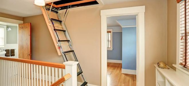

If you can feel a draft coming through the door leading up to the attic or around the hatch, then insulating is going to save you money on your heating bills. Before you do anything, however, moisture problems or major air leaks will have to be dealt with first. Any water or moisture will ruin your efforts and it might be better to fix a leaky roof rather than spend money on insulation. Also, any windows or vents that lead to the outside will have to be properly caulked or sealed.
If you don't have a large budget, a cheaper solution could be to seal the area leading to the attic. An attic door can be weather-stripped and a draft snake can go on the bottom of the door. An attic hatch can have foam board applied to the back side as well as weatherstripping along the area where it meets the ceiling. Sometimes installing trim around the square opening can prevent drafts coming in through the drywall.
