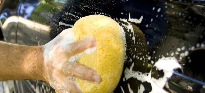

Washing
First you need buckets, not just one, but two. Then you need a decent car wash product such as Meguiars, AutoGlym, or Poorboys. Under no circumstances should you use washing-up liquid as this contains ingredients that attack the shiny topcoat of your paint and will make it dull over time. Your first bucket should be filled with hot or cold water (it makes no difference except to your hands) and the recommended amount of cleaning product.
Your second bucket should be filled with plain water and will be used to rinse out the applicator, ensuring that you don’t contaminate your wash mixture with dirt. Traditionally, the humble yellow sponge would be dunked into the wash bucket, but for the best results, a wash mitt should be used. The reason for this is that a sponge has a flat surface that can collect grains of dirt or specs of grit that, when rubbed across your cars bodywork, cause minute scratches and "swirl marks" that ruin the look of your paintwork.
A wash mitt avoids this by trapping anything harmful into its deep pile of fibres and then remove it when you rinse it in your second bucket. Now you are armed with your two buckets and a wash mitt, it is time to put them aside and turn your attention to preparing the car for washing.
Rinse the car using a hose or buckets of water. If using a hose, the stream should be like rain on the car, rather than a strong jet of water, as this can blast dirt into the paintwork. Using a separate mitt or soft sponge, clean the wheels with alloy wheel cleaner or some of your wash mixture and ensure that any loose dirt under the wheel arches has been removed.
With the car wet, start at the top and work down with your wash mitt, remembering to rinse in the second bucket regularly. Side-to-side strokes are perfect for the washing phase and pressure should only be used on any tough spots you may come across. When you have cleaned the whole car, empty your buckets and get the hose to rinse the car off.
